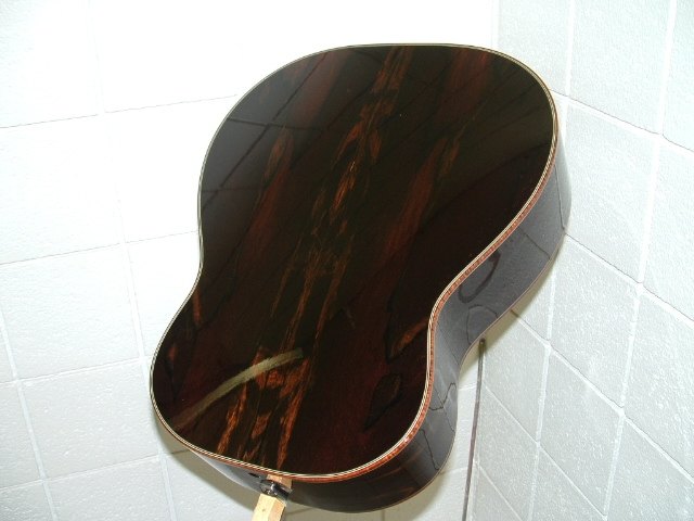

The first is a shot of the back. Brazilian rw w/ Koa bindings.

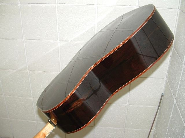

Next is a shot of the sides: (same woods )

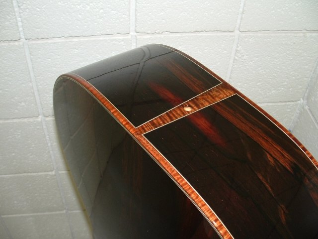

Ok, now the tail end:

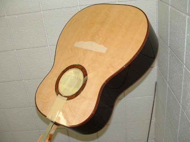

Finally, the top--bearclaw Sitka, w/ a Koa ring bordered w/ Paua:

OOOOOH GORGEOUS! What a nice guitar Steve, is it for you?And such a fine combo, i hope this one isn't a commish?
Nice bindings, works well with the BRW!

That looks sweet. I really love koa as a binding.

Serge--it is in fact a comish. On this one, the customer picked out everything for this build. (I think he did an excellent job!) Those Koa bindings were from an orpan set of sides purchased from Doug Degenhart when he was still living in Hawaii. The good old days.... )

i see those little registration holes for the bridge. looks like they've been drilled through the ends of the saddle slot. i'm wondering if that' preferable to drilling through the E string holes for keeping everything straight for the gluing.

Phil, thank you so much.
I don't suppose it really matters much how you register your bridge. I use holes in the saddle slot because--I guess--I'm used to that technique. You could drill out the E string holes, no problem. But I prefer to wait till the bridge is glued down before making that serious a hole in the top. (Well, other than the sound hole.) Plus, the 3/32" holes will now be ready for any future undersaddle pickup installation.
Not much of an answer, sorry....

Super combo of materials -- I look forward to seeing it finished and close-up of that rosette.
